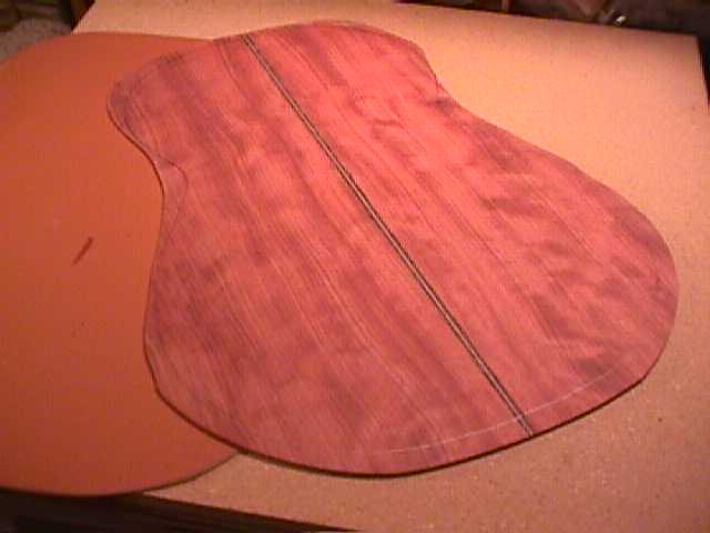

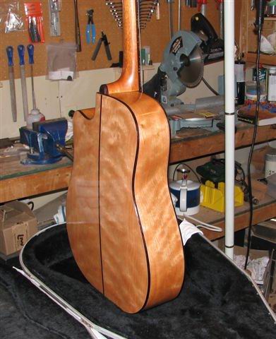

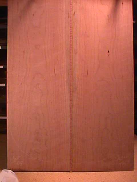

My third going right now is a J-35 style Curly Cherry B&S with a Curly Maple backstrip bordered with black perf on either side.

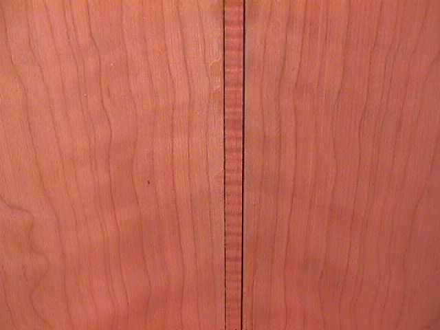

Close up of backstrip before final cleanup and sanding

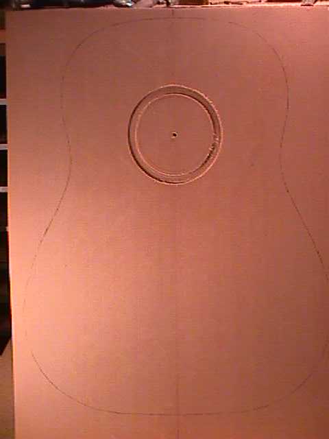

Bearclaw Sitka Spruce top partially routed for rossett

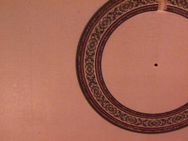

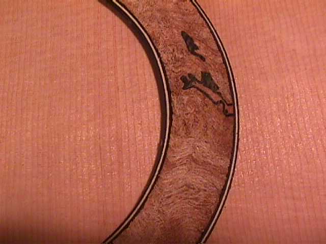

Rossette before inlay, Curly Spalted maple with B/W.B perf inside and out

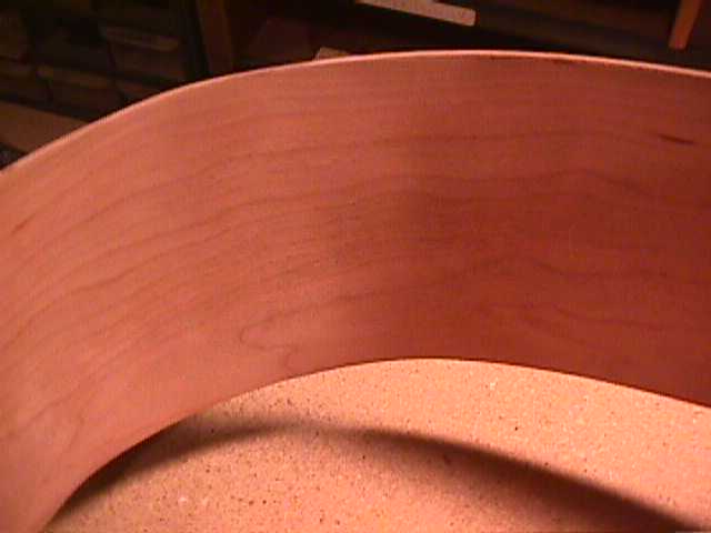

Sides are thicknessed, bent and sitting in a holding mold

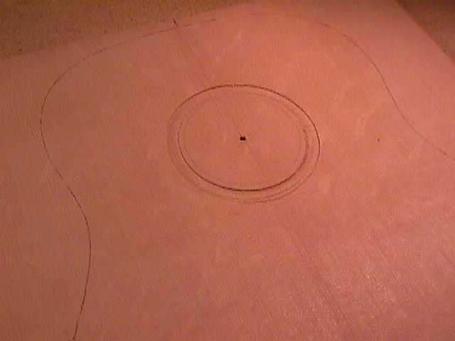

Another shot of the top

This next is my first Classical attempt that is moving along in the batch with the others and is ready for assembly.
Beeswing Bubinga B&S - Engleman Spruce Top, dark walnut bindings - BRW bridge - IRW fingerboard.
the back

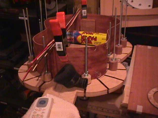

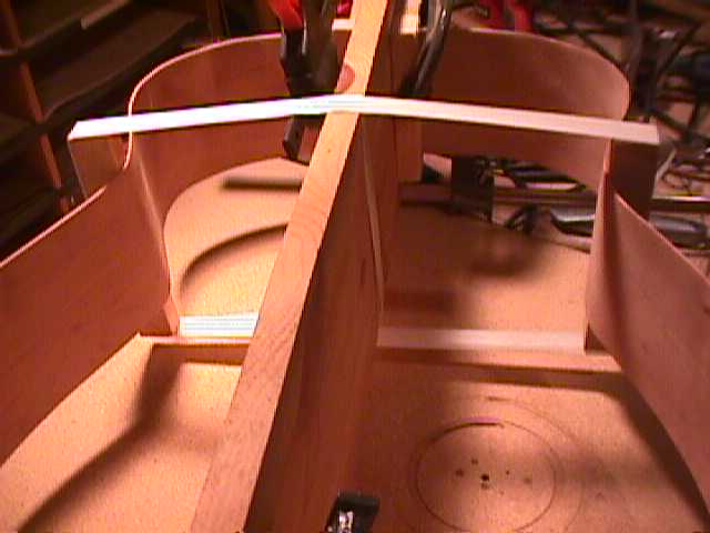

The sides are in the spool clamp work board

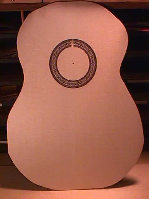

The Engleman Spruce top with rossette inlayed
Closeup of the rossette

*sigh* Recently I thicknessed a piece of my stash of cherry, and it looks very familiar to yours; it's all sitting out there waiting to be worked on...if only I could grab some time.
I am still undecided about what bindings to use...do you mind telling me what you have chosen?
I'm gonna follow your build with interest; was the cherry easy to bend?

Sam, on the Cherry guitar I am using Curly Maple bindings.
PostPosted: Mon Oct 30, 2006 3:37 am
Sam, sorry for not answering both questions, the cherry bends really easy and nice, I thicknessed the sides down to .80 and when it heated to around 240 it started to give, I took it on up to about 290 for the complete bend. You will really enjoy working with this wood.

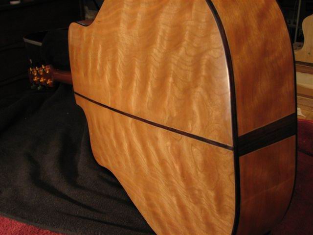

Sam, here's cherry bound in EIR, to give you and idea...

[QUOTE=Alain Desforges] Sam, here's cherry bound in EIR, to give you and idea...
Thanks very much for posting that photograph. I was actually thinking of using EIR bindings, although the figure on my cherry wood ain't as wild and beautiful as that!!!!! WOW!!
